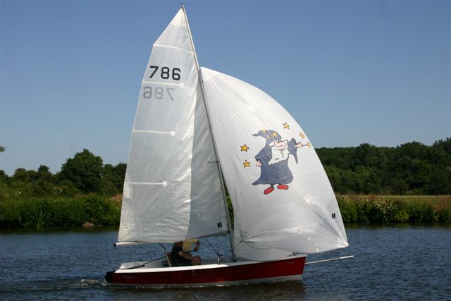

Posted - 10 Aug 2006 :  11:54:40  Show Profile  Visit pcmoyes's Homepage  Reply with Quote
This is how my boat setup i hope you can open the attachment
Philip

rather belated response but ... a large enough bowline to make sure the two patches are separated when you drop the kite will make pulling it all in much easier. some people fit a bobble but then some say the extra weight is a no no (we've just never got round to trying it). As for the tack line length, it can be helpful in light airs when you're trying to sail as low as poss to have a longer tack line so the kite flies further out from the main; in effect you're lengthening the luff to try and convince it that it's a symmetrical spinnaker. We do fit a bobble at the end of the uphaul to separate the head from the mast by an inch or so.
